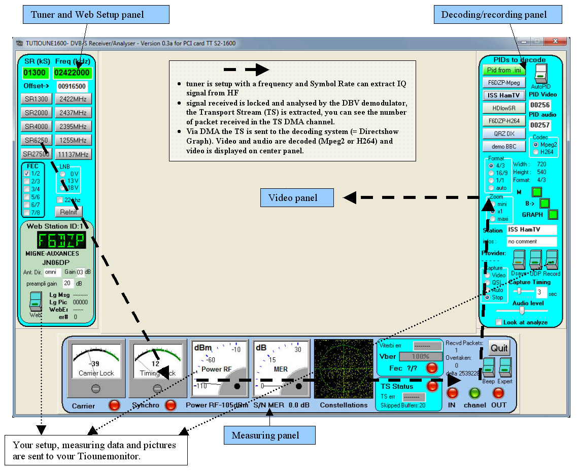

When you start Tutioune1600, it will use the tutioune1600.ini file to setup its buttons (preferred frequency, SR, PID, FEC and voltage, I say more about that later).
I suppose the default setup ( first freq and SR buttons) give you no signal for the moment. You are waiting for an ISS pass to receive HamTV.
you will see that presentation, showing 4 panels:
-Tuner and Web Setup panel
-Measurement panel
-Decoding/recording panel
-Video display panel
tutioune1600 standard_en_waiting HamTV explanation.jpg (273.25 Kio) Vu 91602 fois

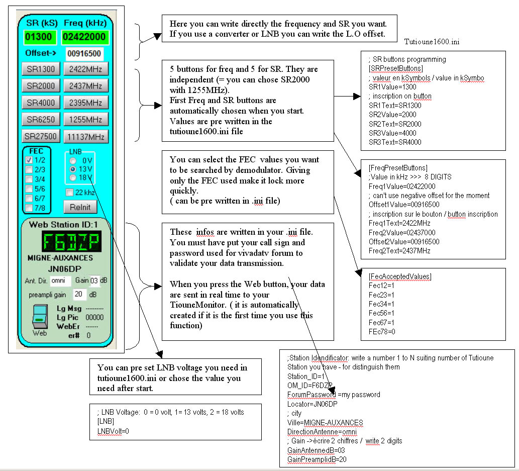

This panel uses data written in tutioune1600.ini file to show your preferred frequencies and Symbol Rate. You have just to click on a frequency, click on one SR value and the tuner will use these values.
You can also set 13v or 18v if you need it for your converter, pre-amplifier or LNB.
22kHz is use for some LNB to switch from LoBand to HiBand.
the Web info ( coming from tutioune1600.ini file) will be sent to your Tiounemonitor when you will press the Web Button.

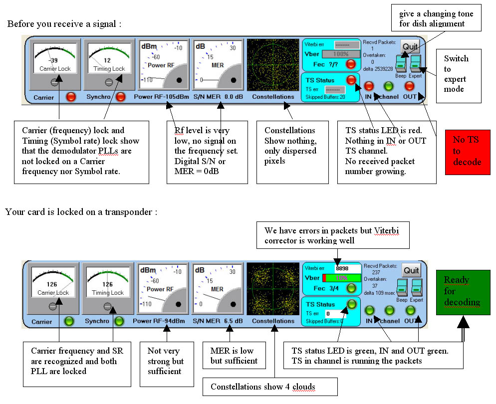

Measurement panel
measurement panel explanation.jpg (222.13 Kio) Vu 91595 fois

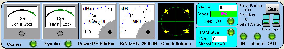

with best condition we could have:
measurement panel mer 26dB.jpg (71.11 Kio) Vu 91594 fois
Carrier Freq lock and SR timing lock are similar but RF level better, and MER at its maximum : 26 dB. Absolutely no error to be corrected.

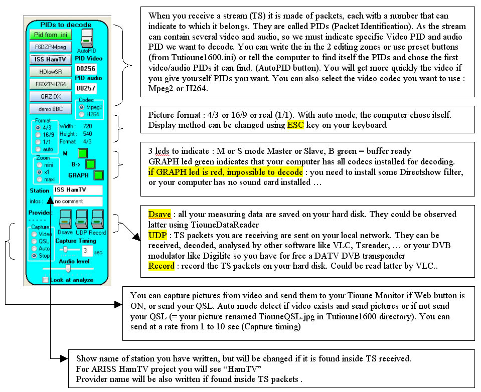

panel PID setup explained.jpg (273.02 Kio) Vu 91594 fois

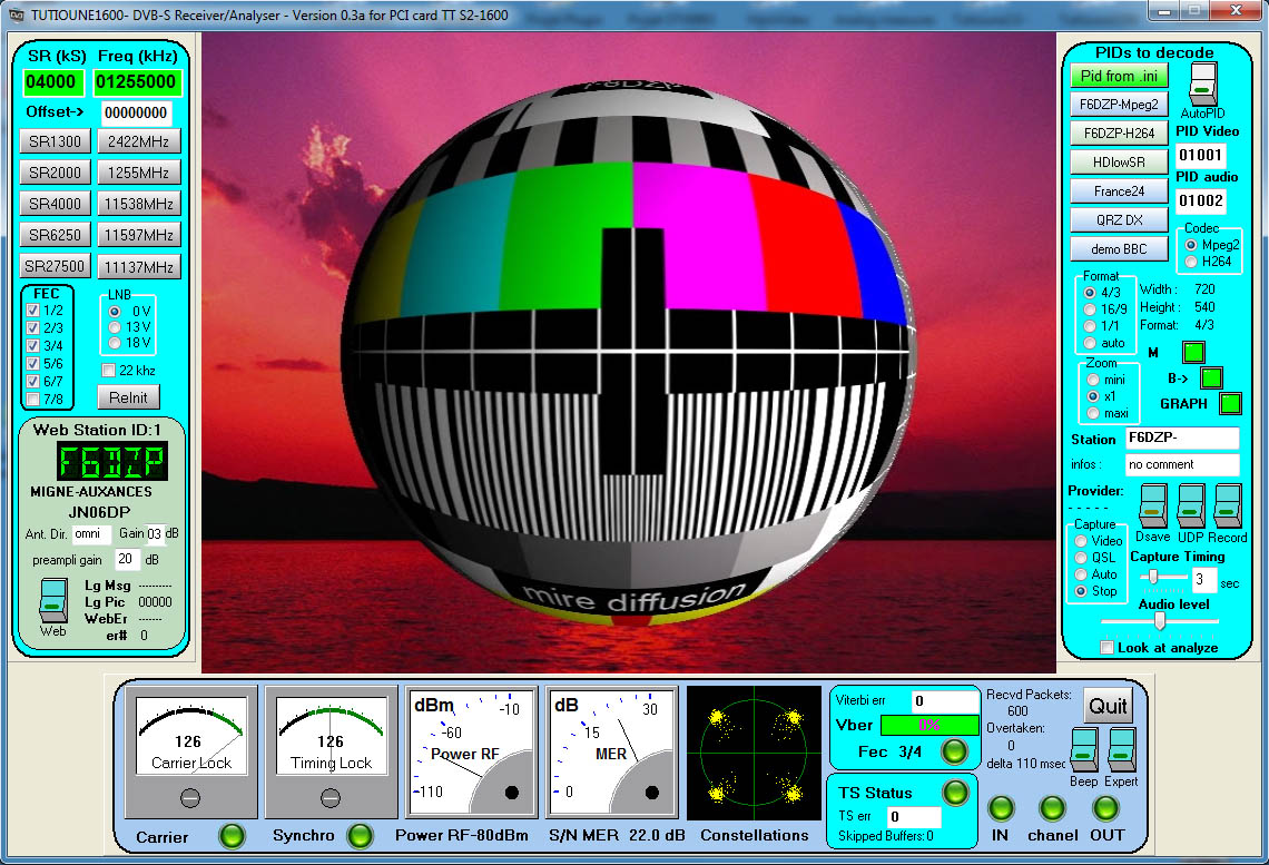

with all led green you can receive and decode video & audio :
tutioune1600 standard_en.jpg (273.81 Kio) Vu 91585 fois
