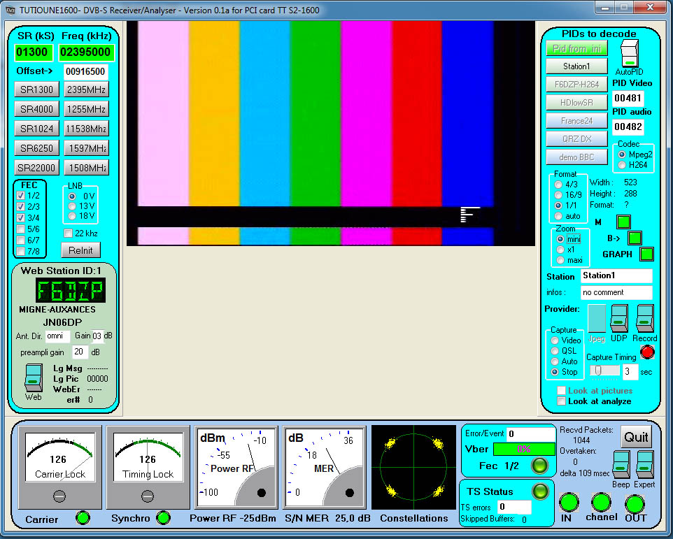

capture SR1300.jpg (234.12 Kio) Vu 130016 fois
the Web button create automatically your WebMonitor like mine:
tutioune.php?om_id=F6DZP&station_id=1
if you ask at right "capture" -->"video" or "QSL" you will see the pictures received in real time on your WebMonitor as same time as measurement.

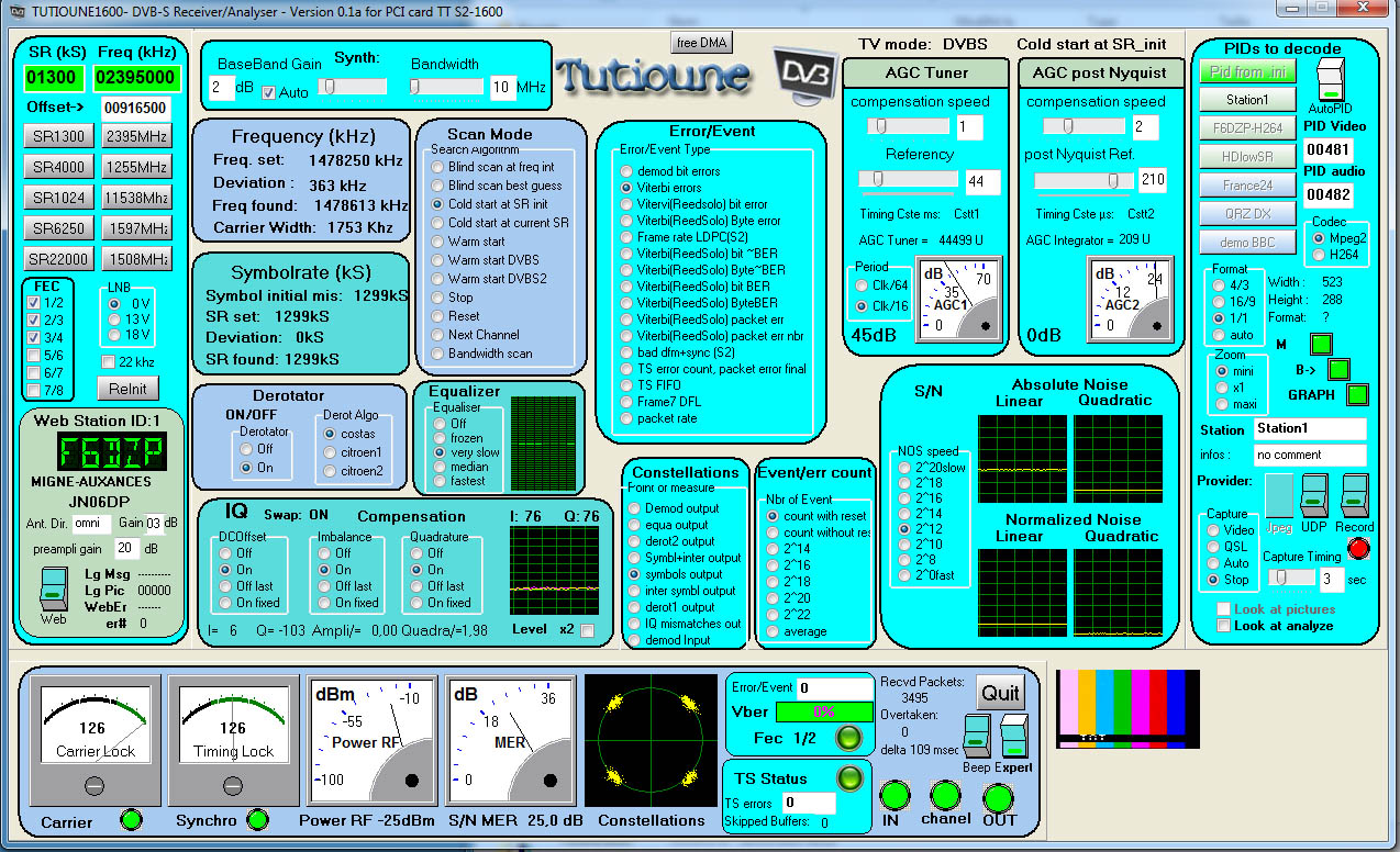

capture SR1300 expert mode.jpg (464.96 Kio) Vu 130016 fois

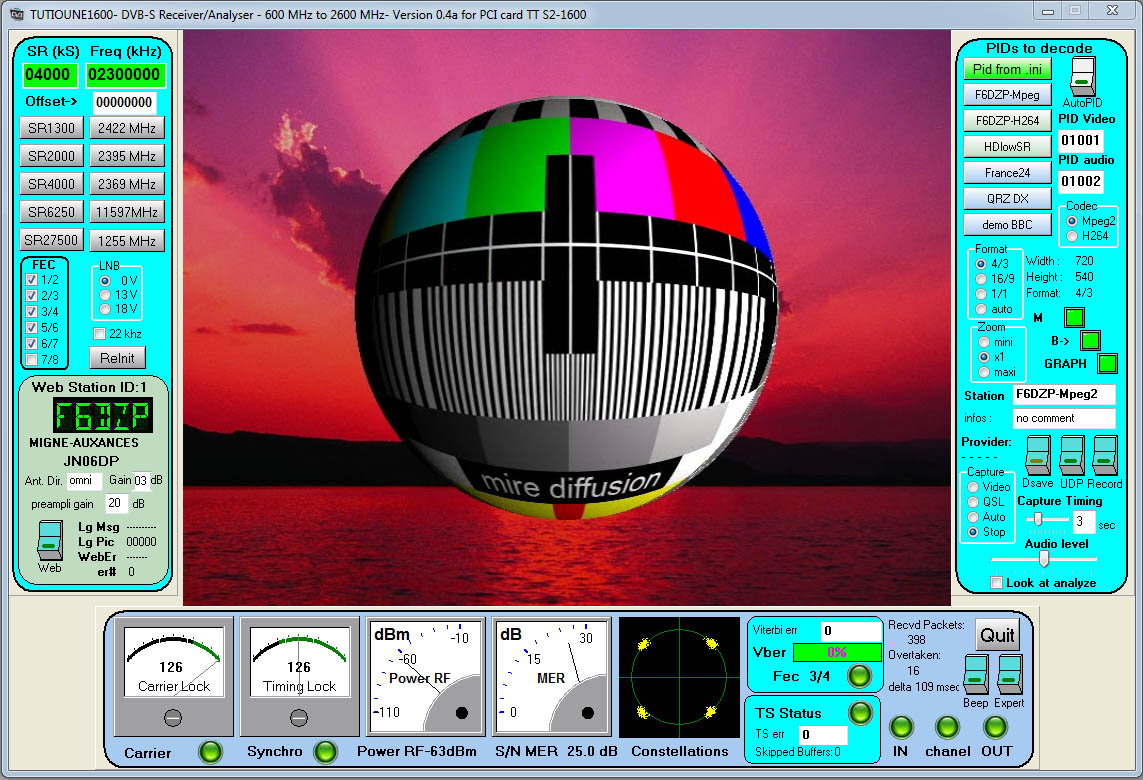

A new version that can receives directly from 600 MHz to 2600 MHz.
Tutioune1600 v0.4a.jpg (274.06 Kio) Vu 129792 fois
>> install tutioune1600v0_4a_en.zip >> see next version(fix DMA issue with some Win7 computer and H264 decoding)
