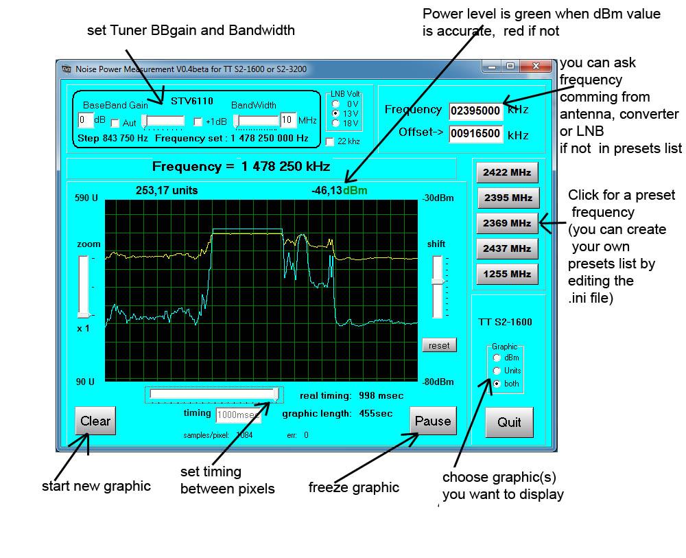

Hello
This last version is supposed to work with both S2-3200 and S2-1600 cards:
NPM V0.4beta.jpg (244.06 Kio) Vu 173087 fois
click here for download:
NPM V0.4beta is obsolete, see next message
You must use Technotrend PCI card S2-3200 or S2-1600. same software for both cards.
Put all files in one folder.
You must install the Saa7146a driver if it is not done.
You can set your own presets by editing the NTM.ini file
