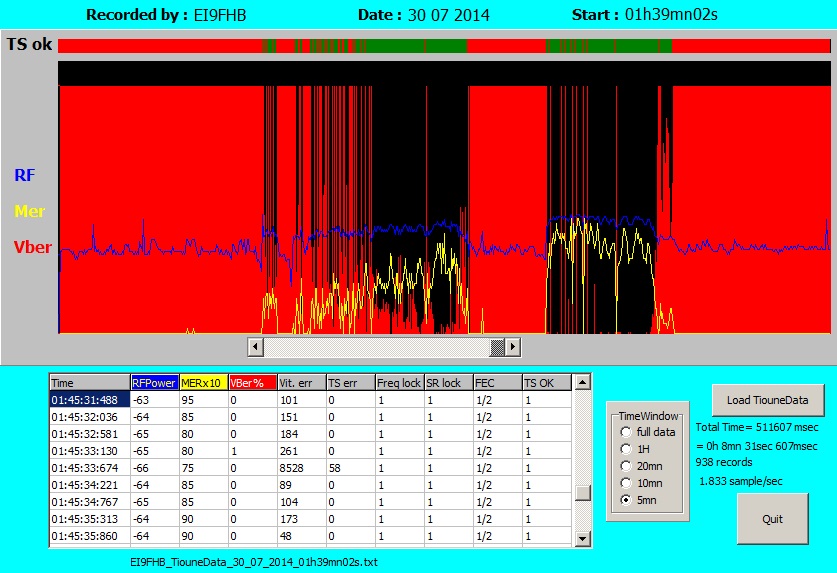

Messagede EI9FHB » Jeu 31 Juil 2014 01:58
30 July Local 144am.jpg (159.62 Kio) Vu 130814 fois
All times are local. (UTC+1:00)
For this pass
30 July
01:41:16 10 Degree Elevation
01:44:27 41 Degree Max Elevation
01:47:39 10 Degree Elevation
EI9FHB
Inscription: 31 Mai 2011

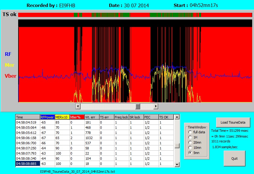

Messagede EI9FHB » Jeu 31 Juil 2014 02:06
30 July Local 458am.jpg (157.95 Kio) Vu 130808 fois
For this pass
30 July
04:54:18 10 Degree Elevation
04:57:30 42 Degree Max Elevation
05:00:43 10 Degree Elevation
EI9FHB

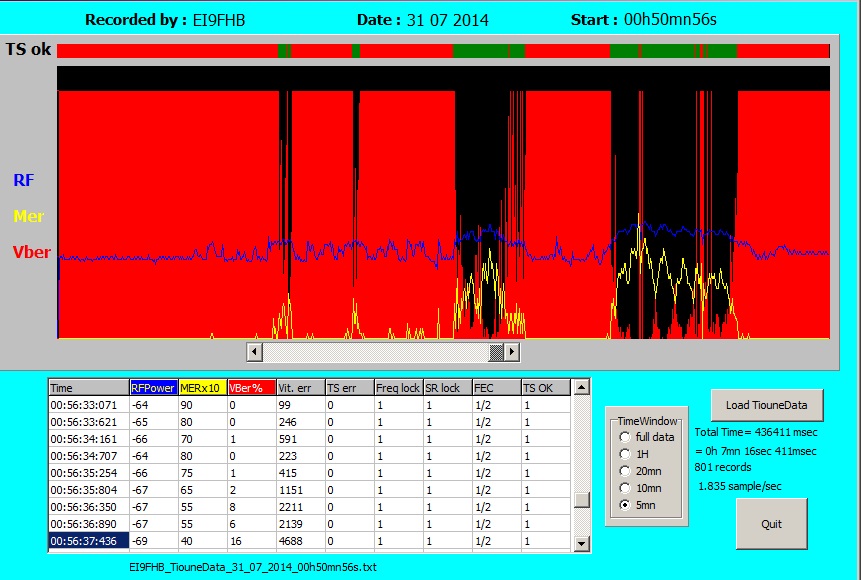

Messagede EI9FHB » Jeu 31 Juil 2014 02:10
31 July 0056 local.jpg (157.68 Kio) Vu 130805 fois
For this pass
31 July
00:52:43 10 Degree Elevation
00:55:44 32 Degree Max Elevation
00:58:46 10 Degree Elevation
Mountains to the South in the way, low elevation pass
EI9FHB

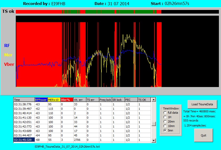

Messagede EI9FHB » Dim 19 Avr 2015 15:27
31 July 231 local.jpg (149.84 Kio) Vu 130802 fois
For this pass
31 July
02:28:51 10 Degree Elevation
02:32:11 65 Degree Max Elevation
02:35:32 10 Degree Elevation

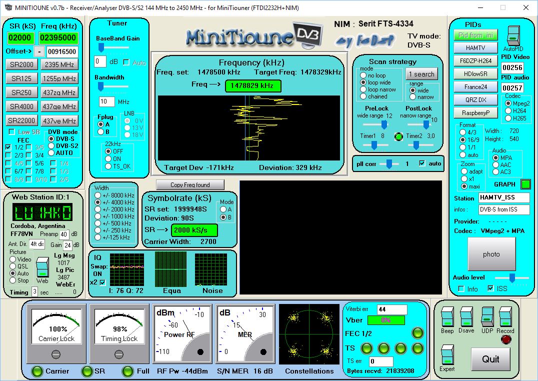

Messagede LU1HKo » Dim 18 Fév 2018 01:17
Hi All:
Finally I do!!
After several years dealing with it, I finally colud setup my Hamtv Station in order to receive a decent video.
This is a capture of the data collected today.
Start 09:33:25 Z 26 degrees
Max 09:36:00 Z 75 degrees
Stop 09:38:45 Z 18 degrees
Harware
LNC Khune 23 ATV
1,2 metres dish Grid MMDS with mesh
Helix (4 turns LHCP)
DigiTwist Rotors
3 mts over ground with various trees near QTH
Minitioune v2.0 (BATC)
SoftWare
Digitwist v.043
Orbitron 3.71
Minitioune v.07b
Windows 10 Pro
Fernando
LU1HKo
Inscription: 22 Avr 2014

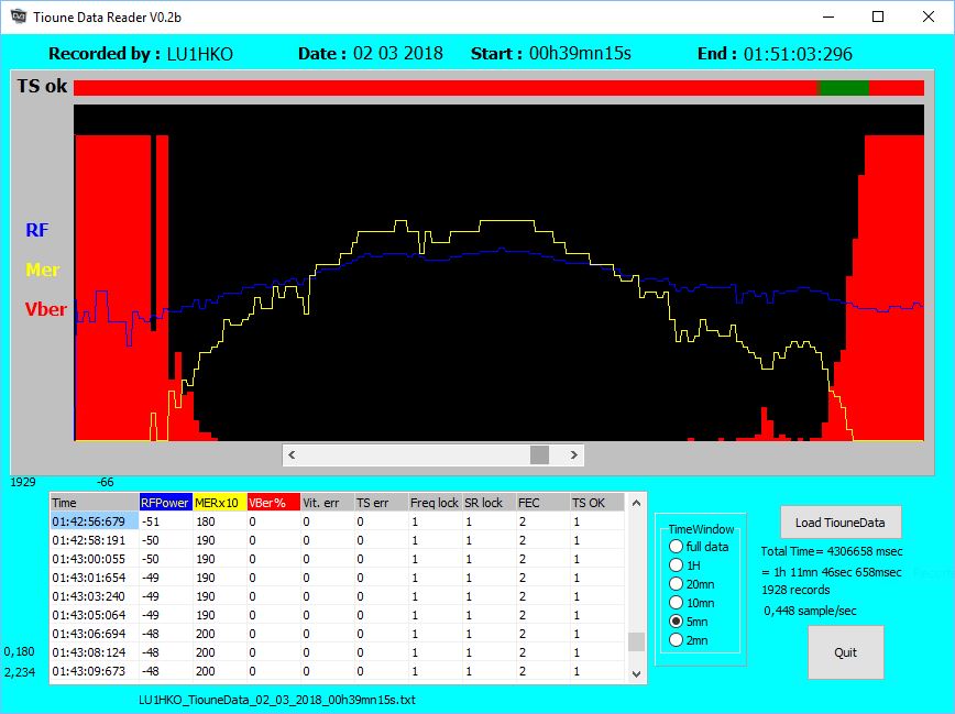

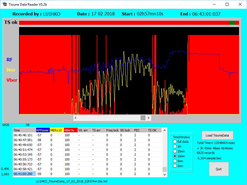

Messagede LU1HKo » Ven 2 Mar 2018 05:11
After Digitwist repair, It was updating every 10 secondes, now repaired updates every second.. RF curve now is much more decent.
73,Fernando,LU1HKO.

Messagede F6DZP » Ven 2 Mar 2018 07:47
Well, a very good result now!
Congratulation Fernado.
Messagede LU1HKo » Lun 5 Mar 2018 02:46
Jean-Pierre:
This was possible with your help.
Brian Jordan also inspired to me to continue it when I see CAT17 at BATC .
Digitwist is a cheap and easy way to move the antenna.
Maybe someday HamTv change black to some video or chart , at least colour Bars?.
It is difficult to speak to others hams that I could download video from ISS having a "black video " to show Hi Hi.
Maybe also someday others South America Hams involved and work with ARISS project with locals schools.
I think we need Chile Uruguay and a couple of Brazilian ground stations. I am dreaming only....
Have a nice Day
73,Fernando,LU1HKO
