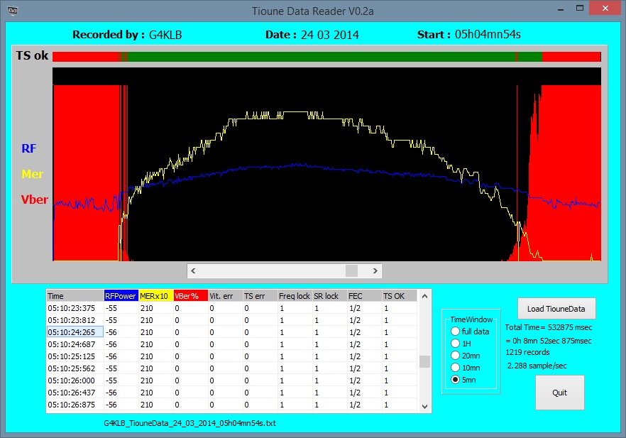

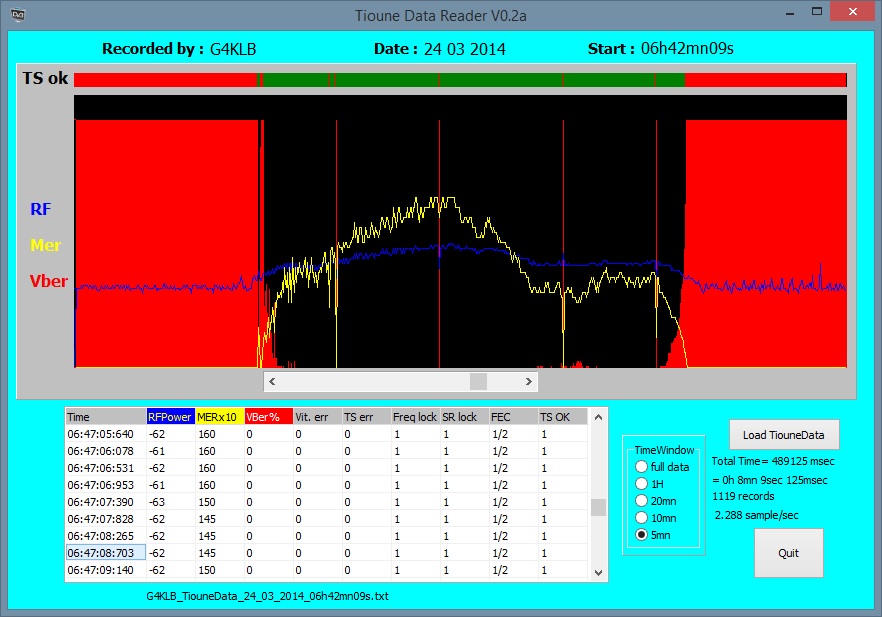

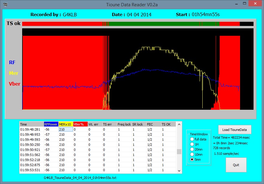

Messagede G4KLB » Lun 24 Mar 2014 05:21
2nd pass for today
2nd 2MS.jpg (141.72 Kio) Vu 91839 fois
Messagede i0kpt » Lun 24 Mar 2014 07:11
Colin, congratulation for the two receptions of yours at 2 MS/s. You wrote that you had the Lost-Of-Transportstream (LOT) at about 1300 km. At which range you had the AOT?
Piero, I0KPT
i0kpt
Inscription: 29 Mar 2013
Messagede G4KLB » Mar 25 Mar 2014 03:24
Hi Piero
AOT was 740 KM, I always seem to get better results when the ISS is moving away from me.
AOT 31.7 degrees elevation
LOT 18.8 degrees elevation
The dish is on the ground surrounded by trees and houses.
Colin

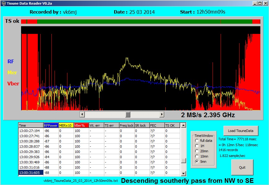

Messagede vk6mj » Mar 25 Mar 2014 05:28
Reception seems better during a pass from the NW heading SE. Continuous Video lock for 6 minutes with some intermittent locks on approach.

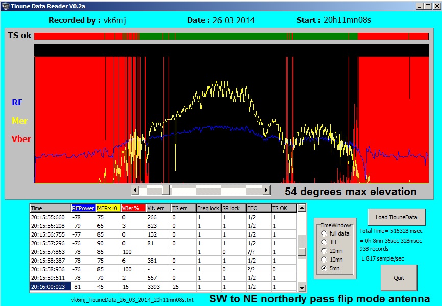

Messagede vk6mj » Mer 26 Mar 2014 12:50
This pass was a northerly ascending pass from the SW to the NW. It was a good elevation around 54 degrees and yet it was shorter in continuous video lock than noticed in my previous log entry. Has anyone else noticed more difficult reception when heading north? I first mentioned in my previous log entry that reception seemed easier or video lock was longer during a southerly pass. These data would support this.
2,395GHz spectrum14.jpg (173.64 Kio) Vu 91808 fois

Messagede G4KLB » Mer 26 Mar 2014 15:05
I seem to get better results on north passes, but my house is in the way for the low southerly passes!
Had a similar result to yours on this one.

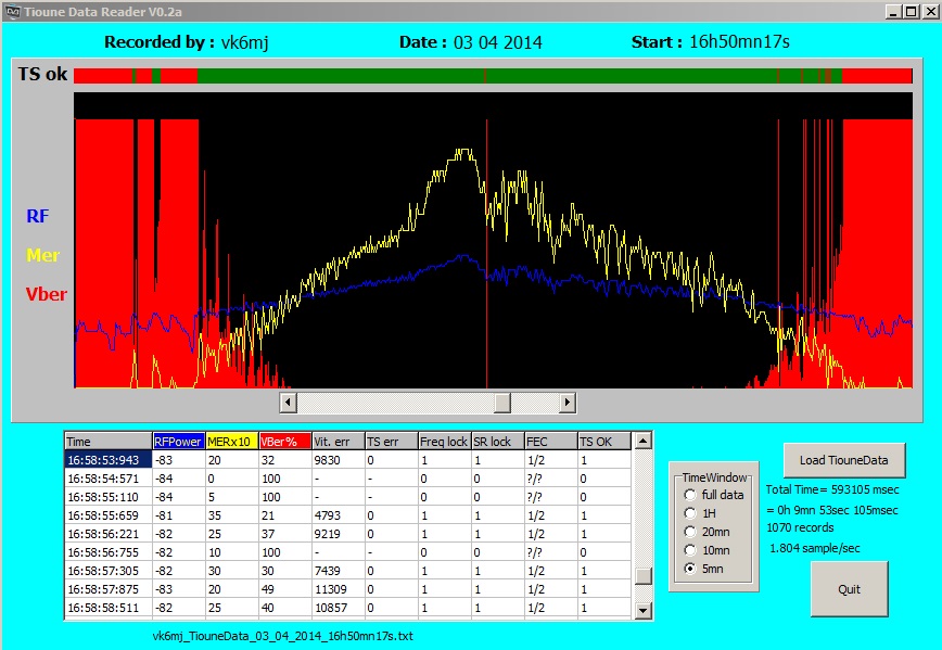

Messagede vk6mj » Jeu 3 Avr 2014 11:24
This pass was a northerly pass from the south west heading north east 72 degree elevation. 6 minutes of video lock.

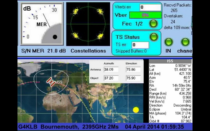

Messagede G4KLB » Ven 4 Avr 2014 01:36
Still tracking passes every night, extra week has been a bonus
040414 0200.jpg (138.59 Kio) Vu 91729 fois
Messagede G4KLB » Ven 4 Avr 2014 01:38
Results are fairly consistant

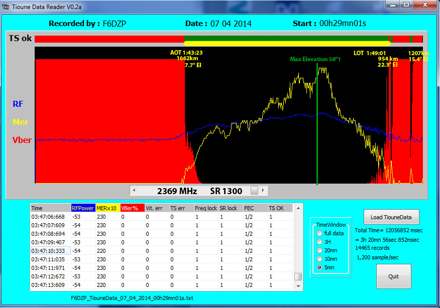

Messagede F6DZP » Lun 7 Avr 2014 06:04
Since Yesterday new Frequency : 2369 MHz and SR : 1300 kS/s
Last pass this morning:
IIS has again change its attitude: we receive best when it comes toward us
This frequency is again very clear for me.
AOT started at 7.7°= 1660 km ( change of ISS attitude) first LOT at 22.3°= 954 km
I had just some lack of receiving under 22° due to some trees and a neighbor house and start again receiving until 15°4 Elevation 1200 km
