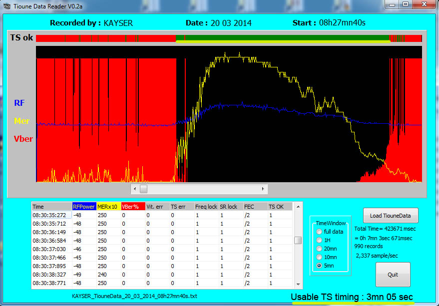

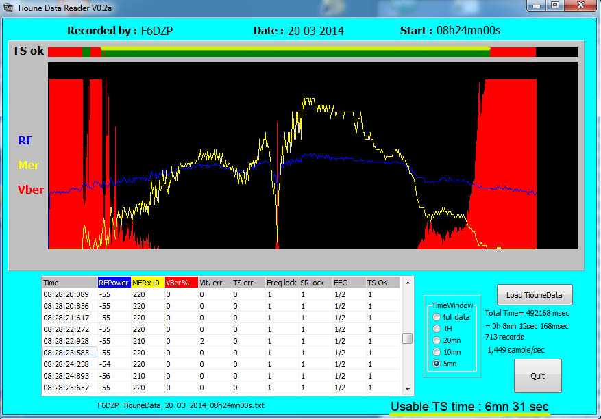

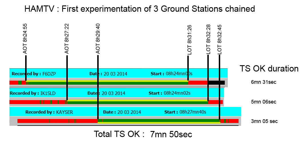

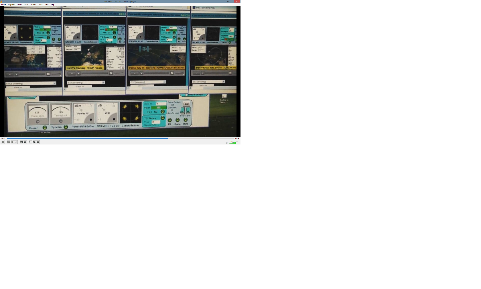

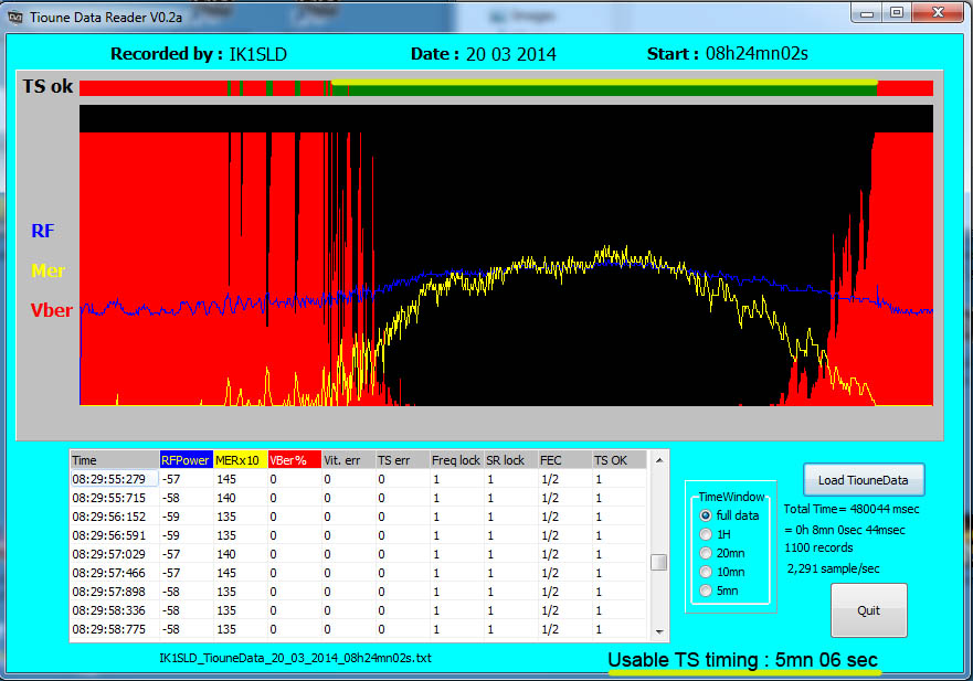

This morning we have made a first test of chained Ground Stations.
==> 1 Ground Station in France and 2 Ground Stations in Italy.
As video received in only a black picture during blank transmission, we decided to show data and principally the TS led that show we are receiving TS packets when it is Green.
All the measuring data made by Tutioune where sent in real time to the ISS MUltiviewer : http://www.noelandsally.net/iss/
I have recorded the result with a video screen capture, you can now rewind as many time you want to see the video. Here it is:
http://vivadatv.org/images/HamTV_20_03_2014_8h24UTC.html

The TiouneData :
Ground stations chained tiouneData.zip
(18.39 Kio) Téléchargé 6440 fois
3 ground stations 20-03-2014.jpg (109.81 Kio) Vu 203092 fois

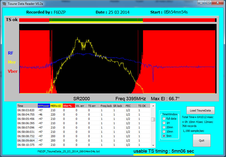

ANother test with chaining 3 Ground stations : the Video
Messagede F6DZP » Mar 25 Mar 2014 08:57
Today a new test with 3 ground stations . SR is now 2000 kS/sec
You can watch the video of ISS multiviewer:
http://vivadatv.org/images/HamTV_25_03_2014_5h56.html
