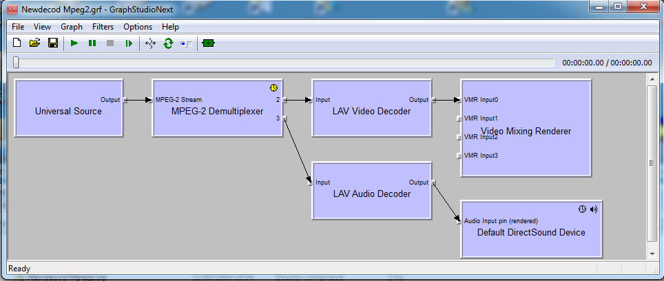

OK Ken, I have received your "Newdecod Mpeg2.grf" file and using GraphstudioNext we can see:
newdecod Mpeg2 graph.jpg (86.39 Kio) Vu 116877 fois
If you look at this graph, it show how window will decode your TS:
* TS packets received are sent by Tutioune in the Universal Source Filter.( usrc.ax) These are packets of data that can content one or several video and audio channels mixed.
* The Universal Source Filter send the data stream to a Microsoft Mpeg2 Demultiplexer that will separate audio and video data that are in the stream and chose only for output the audio PID and video PID you have selected in Tutioune.
* the demux audio output is coded in Mpeg1 layer2= mpegaudio, we need a decoder before sending the data to the sound card. Here Windows has chosen the LAV audio decoder.
* the output of the audio decoder is a decoded audio stream that is sent to your Soundcard by the Audio Renderer: "Default directSound device"
* The demux video output is coded in Mpeg2 so we need a decoder, we see that Windows has chosen the LAV video decoder.
* the output of the LAV video decoder go to the video renderer
So if your video rendering is no very good you have 2 solutions:
1) well set your LAV video decoder
or
2) tell Windows to change to another Mpeg2 video decoder
We first try to tweak better your LAV video decoder.

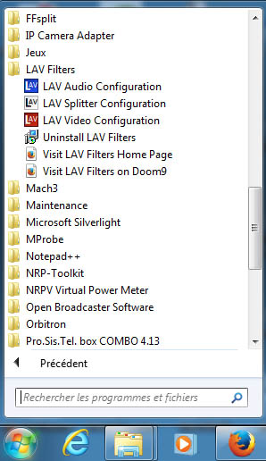

Go to Windows, start --> all programs, find the LAV menu directory and ask for LAV video configuration :
LAV Filters directory.jpg (65.79 Kio) Vu 116869 fois
LAV video configuration.jpg (114.23 Kio) Vu 116876 fois
try now different setup . Restart Tutioune after each change.

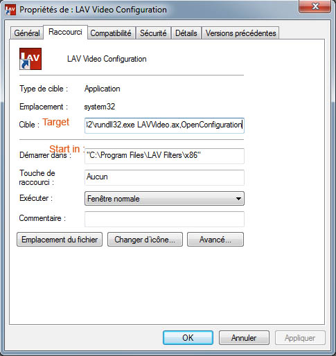

If you don't find the link called "LAV Video Configuration" in the menu, you can create it.
right click on your windows Desktop.
ask for: New_> Shortcut
and create a link that you will name "LAV video Configuration"
and put the 2 sentences for "Target" and "Start in:"
Target --> C:\Windows\system32\rundll32.exe LAVVideo.ax,OpenConfiguration
Start in --> "C:\Program Files\LAV Filters\x86"
Link LAV video Configuration-2.jpg (74.11 Kio) Vu 116868 fois
You will obtain a shortcut that will open the Video configuration utility.

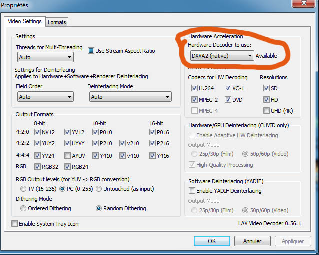

Messagede W6HHC » Jeu 13 Mar 2014 18:33
Hi Jean Pierre,
Thank you for your guidance. Some small differences between our languages did not allow me to immediately recognize that "LINK" == "SHORTCUT" in "windows talk". But soon it was apparent that windows SHORTCUT was the intention of your instructions.
Now, I can see the same tool as you can.
The Hardware Accelerator field was set to NONE.
Also "available" was DXVA2 (native) and DXVA2 (copy-back).
There was NO CHANGE in the video "green stripe", etc....when I change to DXCA2 (native).
However...I do see about 4 seconds of additional latency if I choose DXCA2 (native) instead of NONE??
