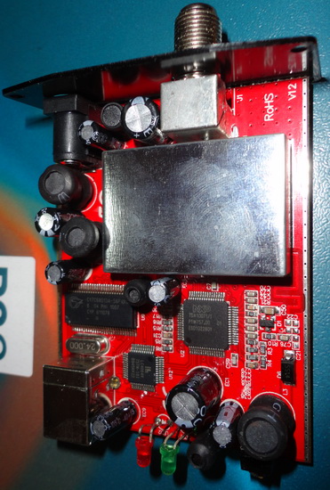

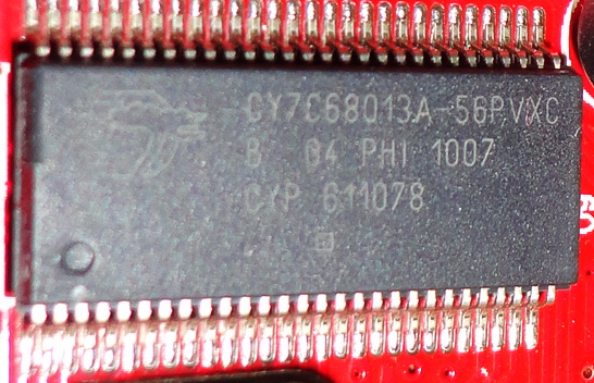

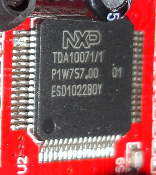

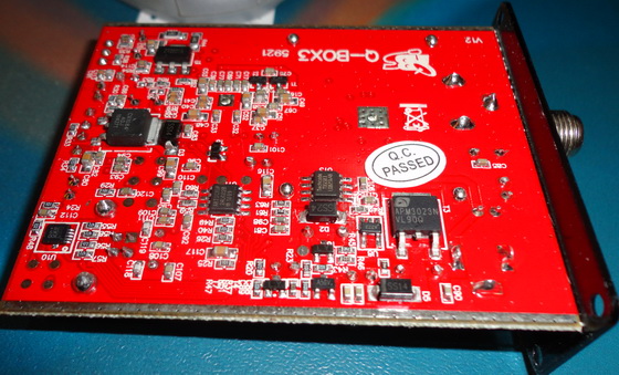

so if it can help You here is few pictures and data for the DVB S2 TV Tuner TBSQBOX3 TBS5921,
Chipset : CX24118A+TDA1007+ CY7C68013
Trident CX24118A tuner, the Trident CX24501 HD decoder and the TDA10071 demodulator
For my pity I think that it is not with a STV0903 demodulator, and with TDA10071/1 (http://www.tridentmicro.com/producttree/stb/satellite-stb/tda10071/)
Here’s a site with chart of comparisons for DVB-S2 USB TV Boxes of that series: TBS QBOX2, TBSQBOX3 and TBS5922.
http://www.buydvb.net/blog/tbs5922vsqbox3vsqbox2.html
I have and an old board SkyStar1 rev.1.3, but have no working PC to test it (but only laptops and this is the reason to choose an USB version tuner)
This is downside of the TV Tuner
This is upside of the TV Tuner
tbs5921-elements side_QBoxIII.jpg (118.34 Kio) Vu 179535 fois
CX24118A
LC4064V 75NT-10I.jpg (67.07 Kio) Vu 179535 fois
TDA10071/1
CY7C68013
CY7C68013A-56P_VXC B 04 PH1 1007.jpg (127.24 Kio) Vu 179535 fois
