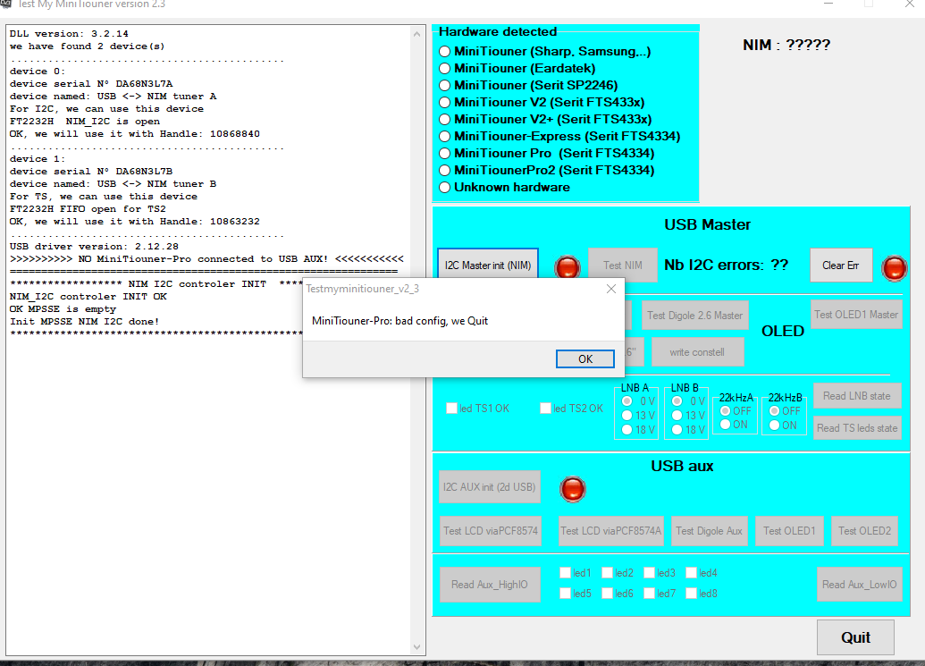

Minitouner V0.9.9.1
When I use "Check Minitioune Driver and Filters" all is OK (all green lights ON)
When I use "Test my Minitiouner V2.3" It can't see Minitiouner and I get "Bad config" message ?? (check pic)
When I try to run Minitiouner I get "Hardware incompatible,we quit" message.
Thank you for your suggestions and help.
73s
Pat

Re: Minitiouner (Hardware incompatible,we quit" message)
Messagede F6DZP » Ven 29 Jan 2021 20:12
If you have a MiniTiouner Pro V2, the FT2232H is already programmed. So you don't have to use FTprog.
I see that you have used FTprog and have erased the good parameters for a MiniTiounerPro V2 so it is normal that the software to check the hardware doesn't recognize your MiniTiouner.
You need to re program the FT2232H with the good template.
http://www.vivadatv.org/download/file.php?id=1118
you have 2 template, one for the FT2232H master, one for the FT2232H aux.

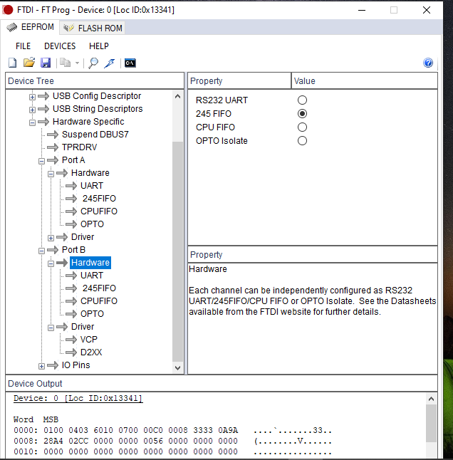

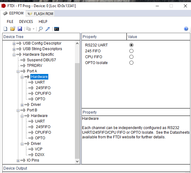

I surely went wrong somewhere, here is what I obtained after programming FT2232H with the new templates.
FTProg Device Tree
Port A
Hardware ---> RS232 UART
Driver ---> D2XX Direct
Port B
Hardware ---> 245 FIFO
PSE check screenshot
Screenshot (7).png (70.61 Kio) Vu 68020 fois
Screenshot (5).png (48.55 Kio) Vu 68020 fois

Messagede F6DZP » Sam 30 Jan 2021 20:44
all is wrong
