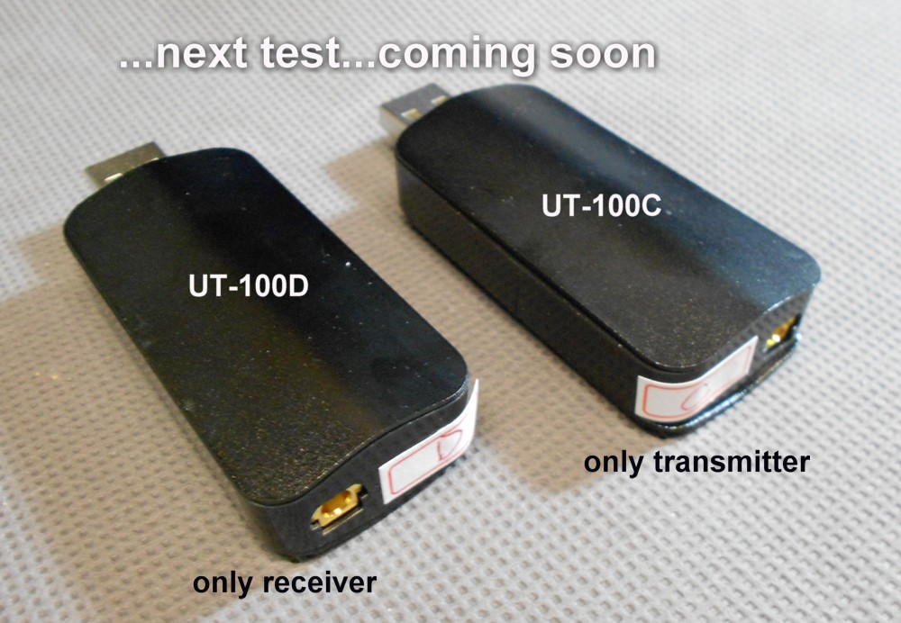

Messagede oe7dbh » Sam 4 Mai 2013 06:49
NEWS !!!!
http://www.hides.com.tw/hot_eng.html
New DVB-T USB Stick variants announced.
UT-100C only transmitter
UT-100D receiver only
Data: http://www.hides.com.tw/product_cg74469_eng.html#310685
prices: http://www.idealez.com/hides/home/en_US

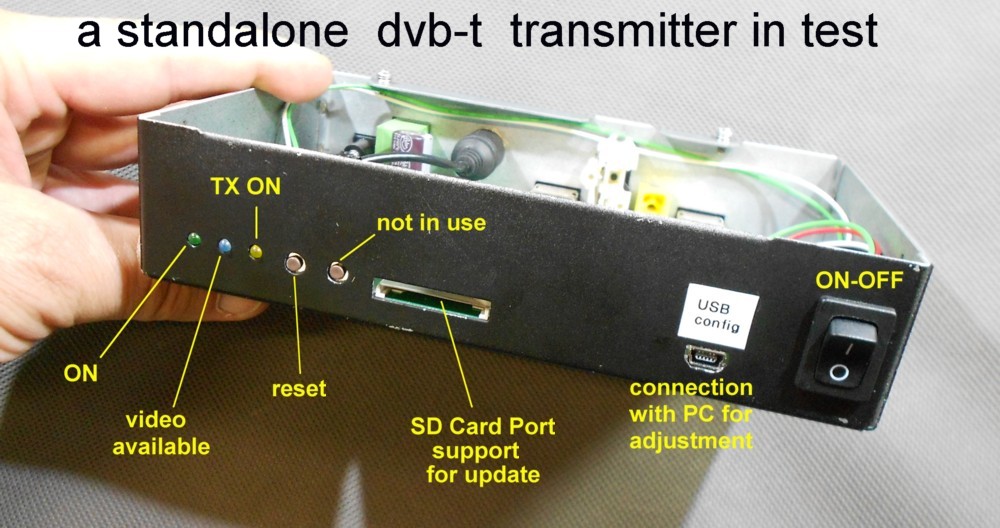

Messagede oe7dbh » Mar 2 Juil 2013 14:57
Standalone 70cm DVB-T transmitters HV-100 in test....
more Pictures on http://www.oe7forum.at/viewtopic.php?f= ... t=30#p1110
Freq.range: 50MHz to 950 MHz ( Future Dualband version 50~950MHz and 1200~1350MHz )
Bandwidth: 2MHz to 8MHz
Resolution: MPEG2 and H264
Output: max. 5dBm
Input: CVBS or HDMI
available beginning August.

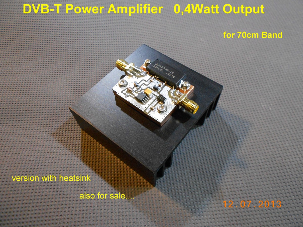

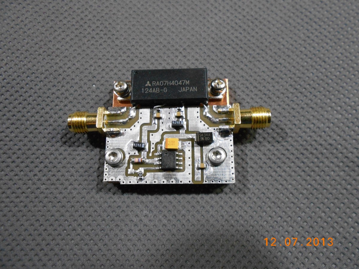

Messagede oe7dbh » Sam 13 Juil 2013 15:10
New amplifier for DVB-T transmitter developed.
more photo:
http://www.oe7forum.at/viewtopic.php?f= ... t=30#p1118
Bild 067a.jpg (356.05 Kio) Vu 456431 fois
Bild 056a.jpg (345.92 Kio) Vu 456431 fois
