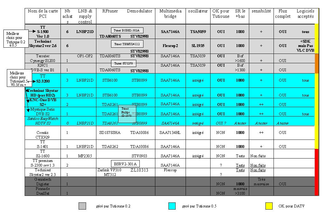

liste des cartes testées en décembre 2010
Messagede F6DZP » Sam 1 Jan 2011 06:57
tableau au 1er décembre 2010
tableau cartes PCI dec2010.jpg (215.62 Kio) Vu 93365 fois
ATTENTION!
Bien distinguer:
-les cartes compatibles DATV, c'est à dire sensibles et descendant jusqu'à 1MSymbol
-les cartes compatibles TUTIOUNE V0.5 (développé jusqu'à juin 2010)
qui n'utilisent pas VerifMatos et la suite Tutioune V0.5f mais seulement Tutioune V0.5
- les cartes avec STB0899 compatibles TUTIOUNE niveau2 = V0.5f avec constellations

Does anyone know of a source of suitable cards in the UK?
I have found the current Technisat SkyStar S2 HD (not HD2 version as per table) and Mystique Satix S2 cards but no STB0890 chip.
As the table is dated 2010 I guess that only old secondhand cards have this chip on-board.

Messagede F6DZP » Jeu 10 Mai 2012 16:56
The TT S2-3200 is one of the best to get with STB0899.
You can find the TT S2-3200 here
http://www.dvbshop.net/product_info.php ... iewer.html
there are also some on Amazon site for £67
http://www.amazon.co.uk/TechnoTrend-TT- ... B000K9GMWG

F6DZP a écrit:The TT S2-3200 is one of the best to get with STB0899.
Hello Jean Pierre,
I've just bought a TT-budget S-3200 card and installed on a Window7 pc.
After installing the original drivers i see in the configuration under system hardware the driver is TT-budget S2-3200 (BDA)
With this driver the card is working to view satellite.
But if i start the CheckSTB0899.exe i get:
PCI cards detection
->No SAA7146A driver and/or card detected.
I suppose this is normal because the driver is not installed.
So i've install the driver with InstallSaa7146a.bat.
If i'm now looking into the hardware of my computer there is exclamation mark before the driver SAA7146A.
and when i run the CheckSTB0899.exe run i've still no cards:
PCI cards detection
Do you know what i'm doing wrong or is the card i bought not compatible?

Messagede F6DZP » Mer 16 Mai 2012 15:24
are you using Win7 32 bits or Win7 64 bits?
I know that there are some problems for the driver to run with Win7 -64bits ( I have not tested, having no Win7-64 for the moment)
With Win7-32bits I sure that the driver runs very well.
